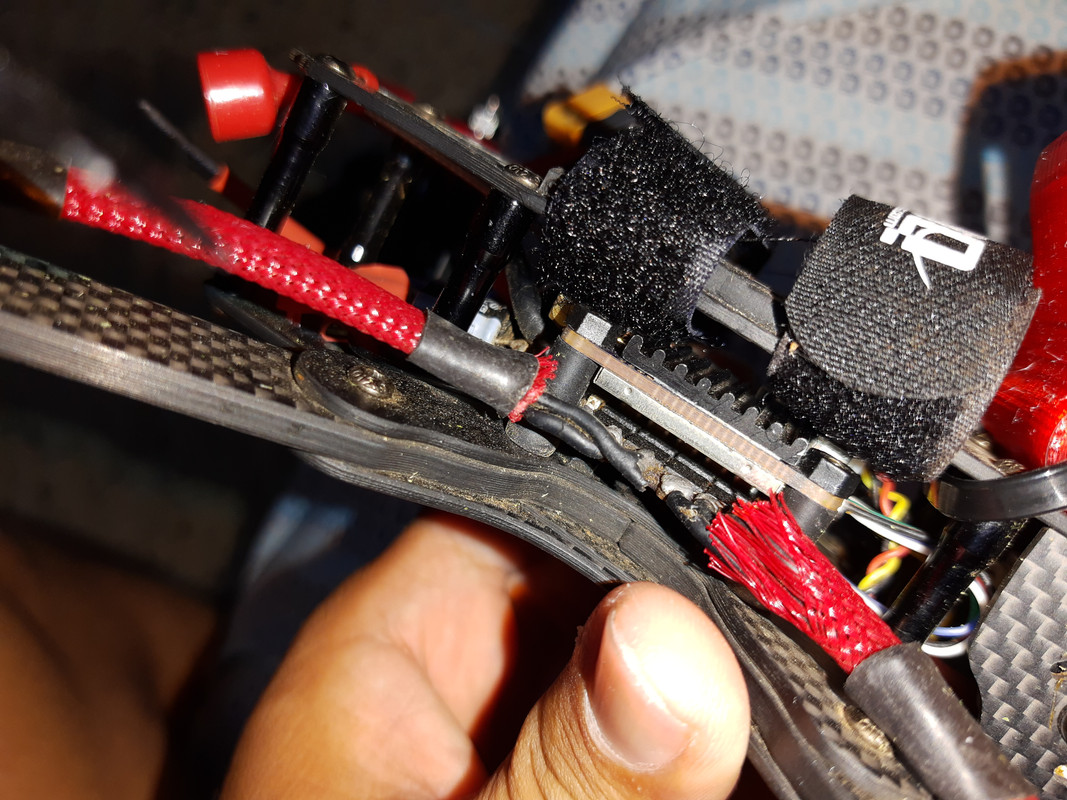

I was in another town meeting up with my family did waiting for the new year to come, and I was thinking "I juat want to go back to my home town and fly", so here is my first flight for 2020, first time also trying to put a "raw" footage of one battery pack. Please bare in mind that regulations here are really ease, therefore I'm not breaking or enforcing people to break any rules.
About the drone, damn, I still can't get rid of oscillations at midtrottle I guess.
Suggestions are always, always welcome!

Yea I am spending all morning trying to tune out oscillations that I can really only see in my gopro is its kind of a pain.

I was just coming back to post that I got a lot of my oscillations out by backing off on my PIDs. I did the n00b mistake of tuning my quads with perfect, brand new setups. After some crashes, the oscillations showed up. I was particularly aggressive on my D's to compensate for overly-aggressive P's. They are still higher than default but I backed off substantially. Also ticked up my filtering from 1.2 to 1.3 (with RPM filtering enabled). So far the oscillations are pretty much gone on both my Chameleon and Apex. I still backed off on P just slightly to see if I could get rid of what little remained.
For what it's worth, I am using TPU vibration dampeners under each motor.

I was flying at default PID, and still got oscillations, I just xant figure out what to move, or maybe I'm lazy and with few time for test.

Even with the default PIDs?? Wow ok what frame are you using?
There's a ton of em on Thingiverse but I think I just used these for my 5 inch builds: https://www.thingiverse.com/thing:2018045 ... You can also just use a few layers of electrical tape and should still absorb some vibrations. I'm not really sure though how much of my oscillations were being caused by my PIDs and how much from mechanical issues like lack of motor vibration dampening (or even FC gyro dampening I guess).

Yes, even default pics. My motors are locked with blue loctite but not soft mounted. I'm using the Iflight XL5 V3 frame (currently not available. Oh oh..) https://www.amazon.com/dp/B07H86FCRQ/ref...dEbMB34PN4.
My FC is mounted over these anti vibration fixed screws, but maybe I did something wrong:
https://banggood.app.link/0NHJH0IYV2
Attached is a picture of the placement.
https://i.postimg.cc/9Qmr6BsJ/IMG-202001...325772.jpg

Hmmm I wonder if it's the mounting of the arms? Are they pretty secure? I mention this because in researching remedies for my oscillation problems where I saw a video of a guy replacing his Armattan Rooster screws and swears it fixed his problems. I was tuning oscillations out of both my Chameleon and Apex this morning. Oddly, the solid body Chameleon had more oscillations issues than the Apex with detachable arms.

Arms are pretty secure, I think one of two screws are broken because of the tightest, but still, rock solid.
